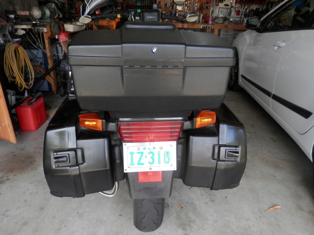

11Back to top Go down   Sequential Indicators easy conversion. Not so easy but solved Empty Turn signal top box Mon Oct 26, 2020 8:09 pm
lefthander
lefthander
Are my eyes decieving me or is that top box a larger version than my standard size?
1992 k75 standard low seat. (transforming into a K75T low seat). roundel
Thou eyes do deceive thee. Standard 22Lt, camera angle makes it look bigger.
Regards martin.
The Mk 1 versions weren't really bright enough in full sun. In the Mk 2 version I fitted two sequential indicators into the OEM housing, and as expected still not bright enough. Onto the Mk 3 version, I had a friend mill out two slots in the OEM lenses. After a little bit of fettling with a Dremel and files I achieved a good fit. I used clear silicone where the indicators fit into the slots and used a hot glue gun to glue the lower one to the bottom of the lens then glued the upper to the lower one with additional gluing at the entry point. A portion of the bulb holder surround had to be removed in order to allow access. As an added precaution I packed the area around the indicators and the back of the housing with heat proof foam.
Initially I had the heat sinks inside the rear indicator housing, however I spent yesterday and this morning moving the heat sinks to a more suitable position on the rear frame rails under the start of the ducktail.  The heat sinks do heat up quite a bit and I didn't want to melt anything. The Mk 3 versions are quite visible in full sun and a couple of guys wanted Mk 3 versions, however only one extra set was made. Apparently it was a nerve racking job and a problem with the CNC machine compounded the stress. I would like to thank Peter from the Trades Guild for undertaking this job twice. He won't be doing any more, he's off to his psychiatrist.
Sequential Indicators easy conversion. Not so easy but solved Pb150210
Sequential Indicators easy conversion. Not so easy but solved Pb160212
Sequential Indicators easy conversion. Not so easy but solved Pb160214
